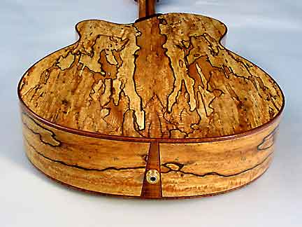

Here is one of the finest examples ive ever seen.
Paul McGill
PostPosted: Fri May 05, 2006 2:23 am
Posts: 107
There's spalting and then there's spalting...
The type of spalting that is actually carried by the tree's system while the
tree is alive and standing produces nicely-defined dark lines similar to
the McGill guitar pictured above and is the stuff most people find
attractive.
I sure do....
